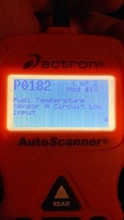

Hello,
I've been trying to determine what this is. I have a 2010 XC90 3.2 and I'm getting a P0182 Error and on my reader it says "fuel temperature sensor a circuit low input ". I tried to find a part number for a fuel temp sensor and it keeps coming up with fuel pressure sensor. I called and talked to FCP Euro and they couldn't find one so I ordered a pressure sensor. Are they the same? If not is there a part number someone can post and it's location on the car? The only symptom I have is the check engine light coming on with this code. Clears and I can drive 15 min in town before it comes back, but there's no noticeable change in performance so far. Thanks!
